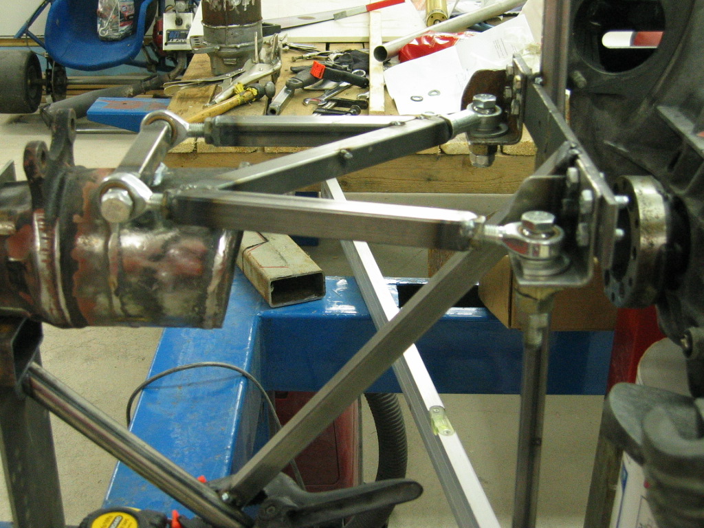

Upper pick up point in its place. I made the actual pick up's bolted to the frame so if i need more radical changes i can just make different kind of pick up points.
(IMG:http://www.914world.com/bbs2/uploads_offsite/fvwa.sitefactory.fi-179-1274376290.1.JPG)
Next will be the lower frame part, pick up's and lower links.
Now it is much easier when i finally have upper links with pick up points and frame part ready. Most of my time today went to measuring and checking that everything is level and pointing in a same direction. I can use this upper frame as my reference point for the others.

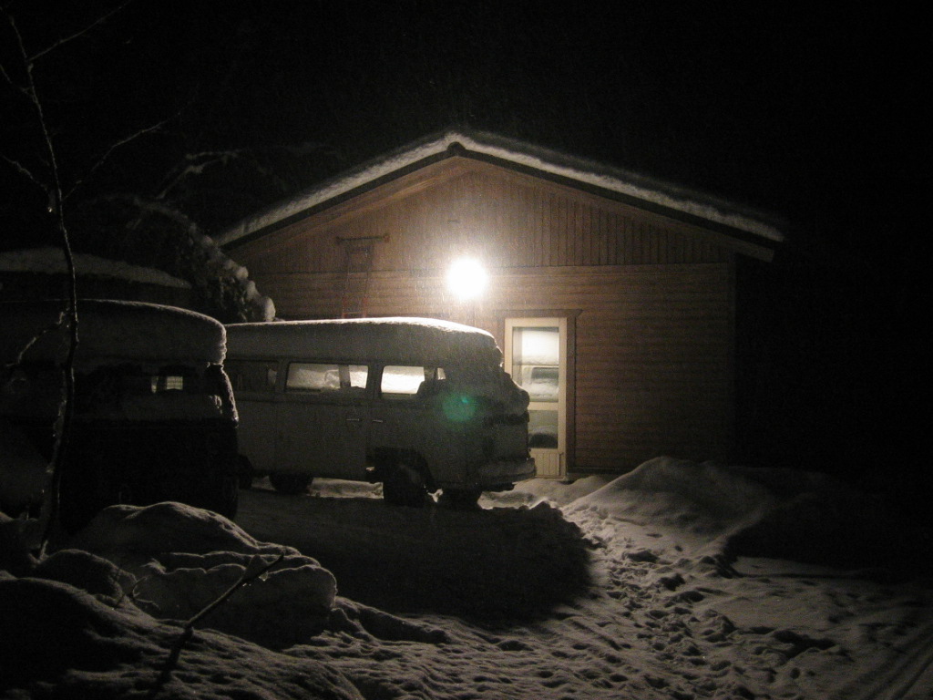

Here is my garage 5 minutes ago
(IMG:http://www.914world.com/bbs2/uploads_offsite/fvwa.sitefactory.fi-179-1274376296.2.JPG)
