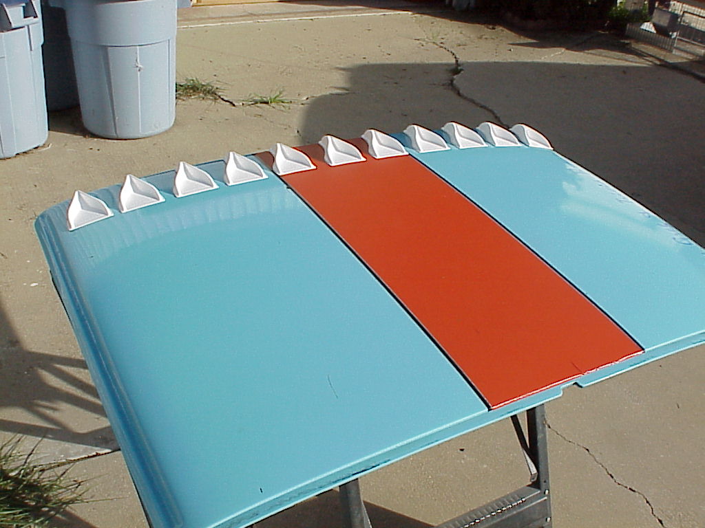

Received my airtabs today and just set them on to mockup the spacing.
Plan is to paint to match the top & stripe.
Going to test with this first before lifting the top.

SirAndy   <...   Jan 10 2006, 05:48 PM
race914   <...   Jan 10 2006, 06:05 PM
TimT   No those are mounted in the correct direction. Ai...   Jan 10 2006, 06:08 PM

gregrobbins   I sent an email to the company who makes Airtabs. ...   Mar 5 2006, 10:29 PM
brant   So the company basically confirmed that If your ru...   Mar 6 2006, 11:28 AM
