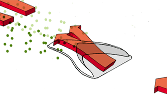

race914   Received my airtabs today and just set them on to ...   Jan 10 2006, 05:15 PM
SirAndy   <...   Jan 10 2006, 05:48 PM
race914   <...   Jan 10 2006, 06:05 PM
TimT   No those are mounted in the correct direction. Ai...   Jan 10 2006, 06:08 PM
