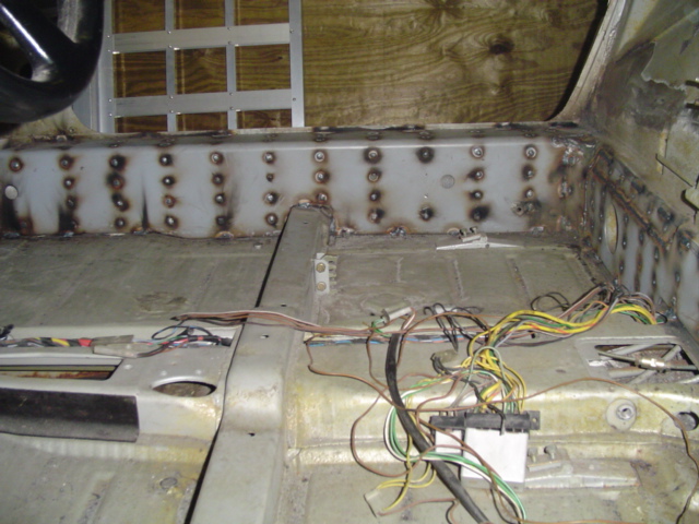

East coaster   Oh yeah, before shot of the jackpost area........y...   Jan 16 2006, 08:01 AM
