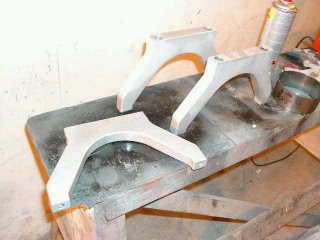

(IMG:http://www.914world.com/bbs2/uploads_offsite/fvwa.sitefactory.fi-179-1274375877.1.JPG)
hub's are attached to table
(IMG:http://www.914world.com/bbs2/uploads_offsite/fvwa.sitefactory.fi-179-1274375881.2.jpg)
lower part of the new front
i'll put more pictures later

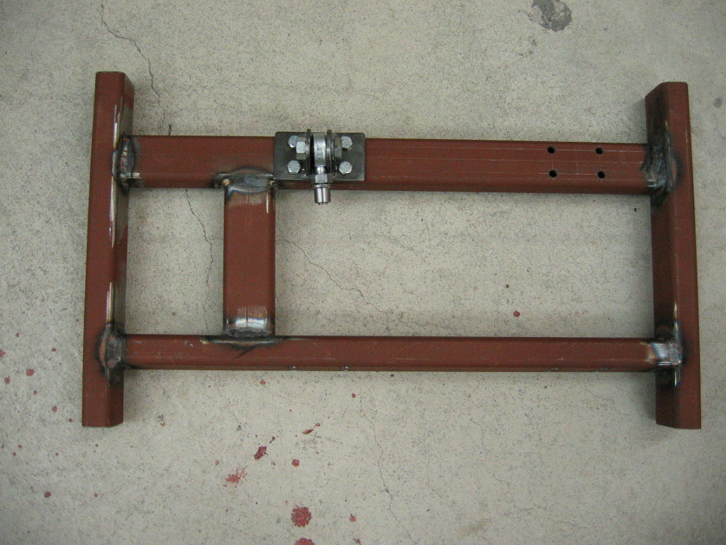

Thats true, after that i noticed that all my trailing arms, includint the current ones are bendt. It is really hard to find stock trailing arms in Finland and it would have taken too much time to build custom ones for stock mounts.
I decided that it is easier to make the rear this way.

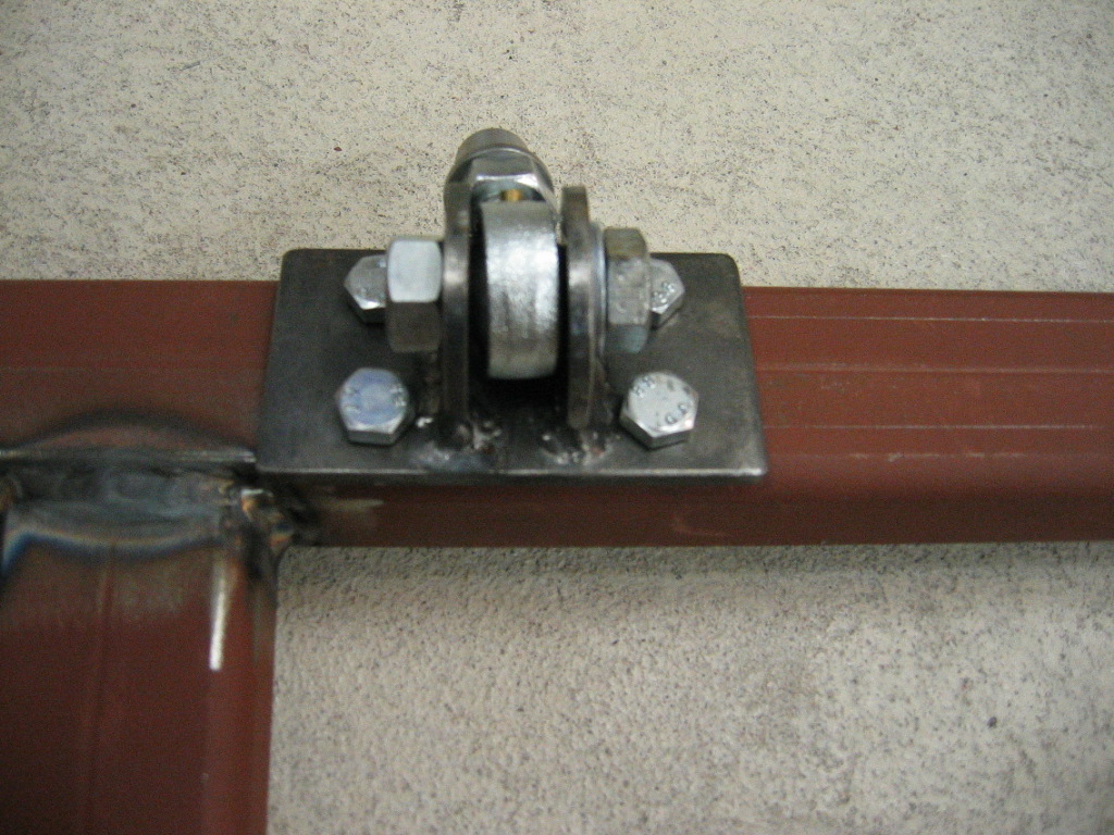

Here is the new frame for trailing arms
(IMG:http://www.914world.com/bbs2/uploads_offsite/fvwa.sitefactory.fi-179-1274376355.1.JPG)
I finally tested my tig welder with this one. I bought the welder 2 years ago but this was the first time i used it, it was really fun.
close up of the first of these thingys (dont know the word in english)
(IMG:http://www.914world.com/bbs2/uploads_offsite/fvwa.sitefactory.fi-179-1274376360.2.JPG)
