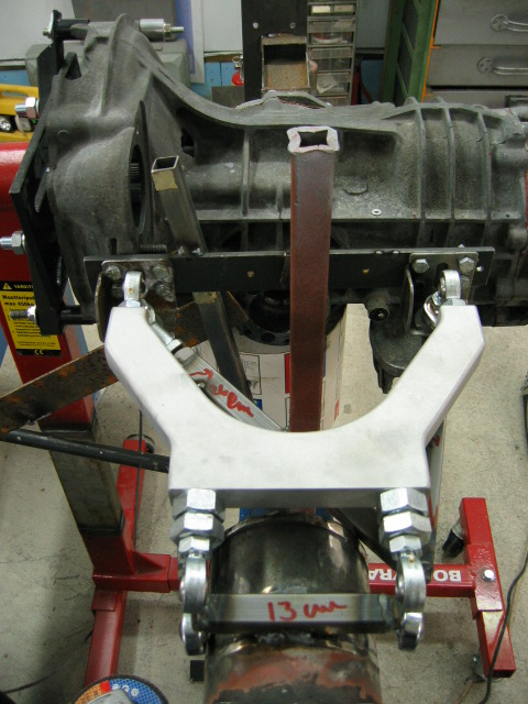

No, i mean the thing that i attach the heim joint.
(IMG:http://www.914world.com/bbs2/uploads_offsite/fvwa.sitefactory.fi-179-1274376393.1.jpg)
