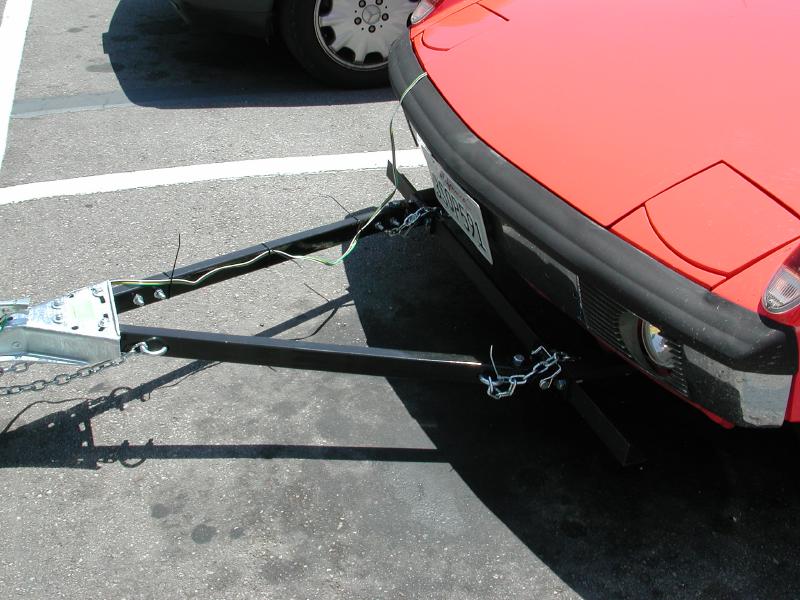

Found some photo's from last summer's trip.. thought I'd reshow them.. now let's see, how do I add pictures ...
This is the adjustable tow bar attached to a bracket McMark welded for me.
