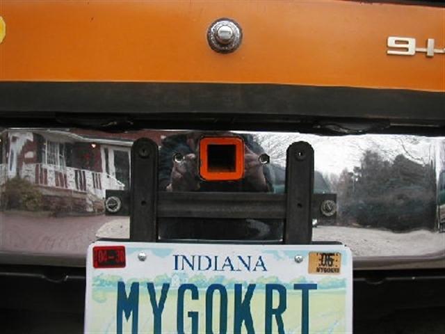

A few more pictures with the bumper on the car. It is still at Brad's corner balancing and such.

itsa914   This will all hide behind the bumper and will be c...   Jan 24 2006, 08:47 PM

itsa914   A few more pictures with the bumper on the car. It...   Jan 28 2006, 03:46 PM
itsa914   http://www.914world.com/b...   Jan 28 2006, 03:47 PM
nynone4   VERY slick Garold! Can't wait to see pics ...   Jan 28 2006, 04:04 PM
STL914   That looks so sweet Garold! Did you do most ...   Jan 28 2006, 04:53 PM
messix   you need a plate bracket from a '68-74 nova or...   Jan 28 2006, 05:18 PM
