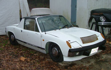

just when you thought you've seen it all... (IMG:http://www.914world.com/bbs2/html/emoticons/ohmy.gif)
yours for $1500
