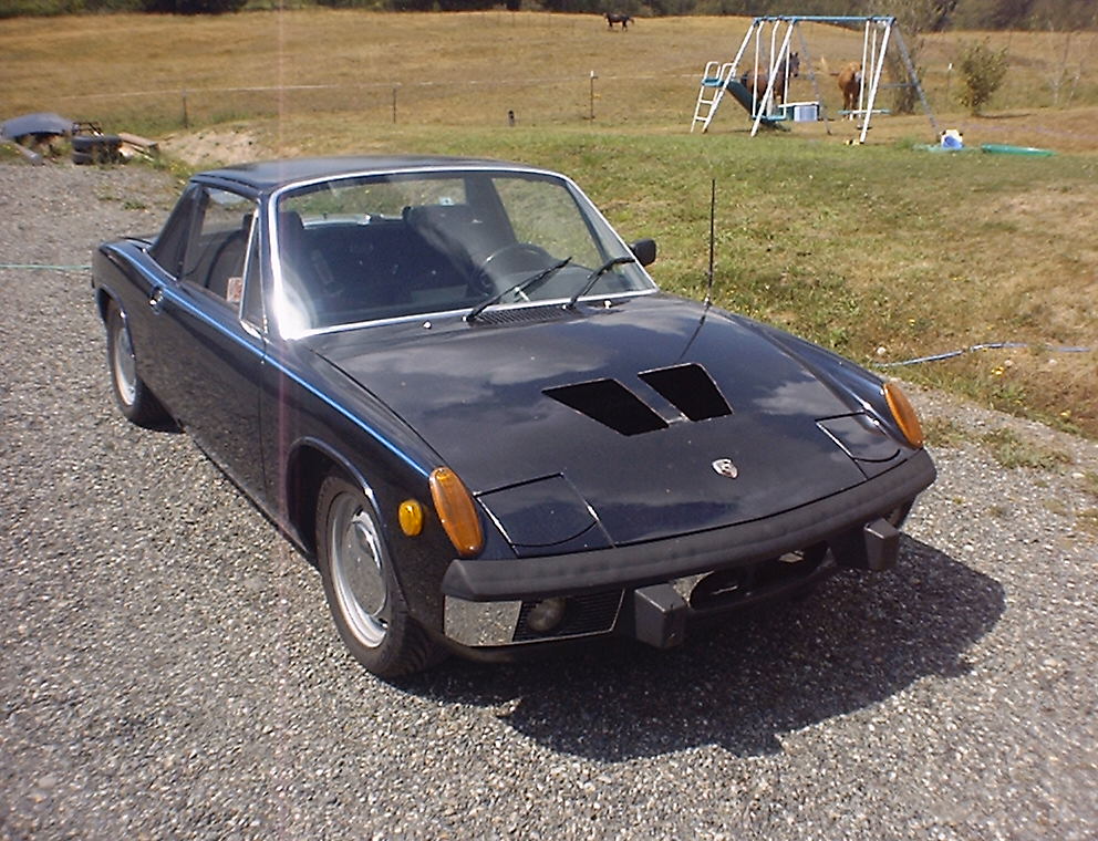

Hi Guys, A couple years ago we took a 914/Chev back to stock for a customer. I then decided to build a 283 powered car for myself. I would like to avoid the huge cutouts in the wheelhouse. has anyone mounted a fan on the trunk floor, possibly with the 2 fans already on the radiator? This would be great for an already AC cut trunk floor. I'd appreciate your input. Thanks! Brad

I have been looking at the hood venting, like the gt-40, the car is not finished the way it is! Thanks for the ideas!!!!!! (IMG:http://www.914world.com/bbs2/html/emoticons/biggrin.gif)

Eddie914   wbergtho, WOW! That vent is FABULOUS! I ...   Jan 25 2006, 09:16 PM

neo914-6   That's similar to Elephant Racings hood vent i...   Jan 25 2006, 10:23 PM
neo914-6   Harry's with leading deflector...   Jan 25 2006, 10:34 PM
neo914-6   Rich cuz has to have one too...   Jan 25 2006, 10:36 PM
Andyrew   I do believe thats me in the pic on the right...   Jan 25 2006, 10:51 PM
neo914-6   <...   Jan 25 2006, 10:58 PM

nick mironov   I have recently completed my conversion and am tes...   Jan 26 2006, 11:04 AM
Andyrew   With the top off, no noticable heat is entered int...   Jan 26 2006, 01:39 PM
