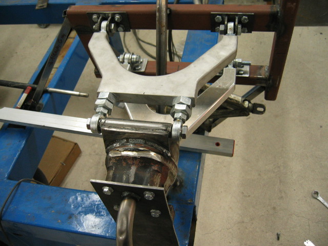

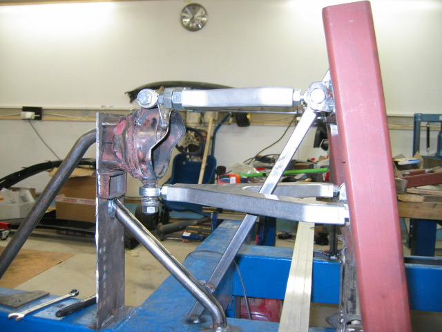

Left side is finally finished.
Hub is ready and whole assembly is welded to table.
(IMG:http://www.914world.com/bbs2/uploads_offsite/fvwa.sitefactory.fi-179-1274376447.1.JPG)
(IMG:http://www.914world.com/bbs2/uploads_offsite/fvwa.sitefactory.fi-179-1274376449.2.JPG)
Tested the suspension travel yesterday and i was happy.
Hubs are going to be made of aluminium later.
Next thing is to make the right side ready and start building
the front axle.
Actually i still need to make the mount for new Koni's to those hubs.

racerx7   It looks very impressive. How do you go about fig...   Jan 30 2006, 01:32 AM
slugmika   I'we been drawing and simulating these in pape...   Jan 30 2006, 03:06 AM
racerx7   First let me say you know a lot more than I do. I ...   Jan 30 2006, 04:19 AM
slugmika   At the moment toe is not changing thru the travel ...   Jan 30 2006, 05:09 AM
