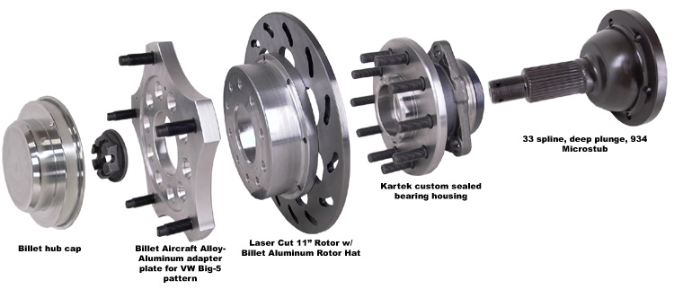

The microstub setup BrettW was talking about can be found at http://www.kartek.com This setup is commonly used in off road buggy racing.
I've attached a picture as well.
