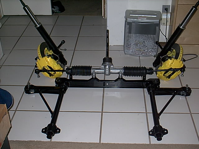

Jaiden   Guys Settle. I put more pics in my blog Both si...   Feb 4 2006, 01:31 PM

Dr Evil   Jaiden, Is that your front end in the pic? Already...   Feb 4 2006, 01:58 PM

Jaiden   Yup, That's mine. It took about 2.5 hours to ...   Feb 4 2006, 06:43 PM
