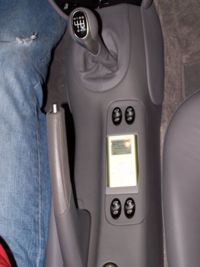

Here is my IPOD solution for a new 996...

WRX914   Without the IPOD...   Feb 7 2006, 06:05 PM
