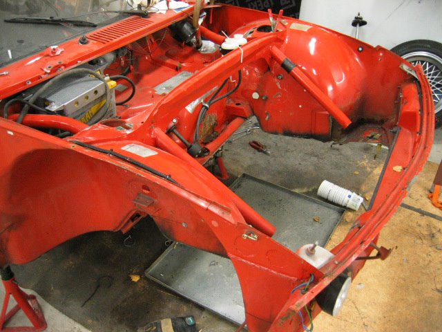

I had to make it public. That's the only way i'am going to get anything done.
So, i had to convert my rear suspension to multi link, raise the front suspension, built a new pedalbox, rebuilt the engine and tranny, make attachemets for new fg flared rear and front fenders, make a new carbon top, glue the new heated windshield, paint the car and lots of other stuff.
I will post pictures when ever i have any progress.
Here is the starting point
(IMG:http://www.914world.com/bbs2/uploads_offsite/fvwa.sitefactory.fi-179-1274375877.1.JPG)

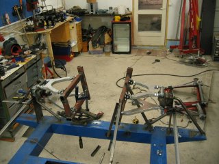

hub's are attached to table
(IMG:http://www.914world.com/bbs2/uploads_offsite/fvwa.sitefactory.fi-179-1274375881.2.jpg)
lower part of the new front
i'll put more pictures later

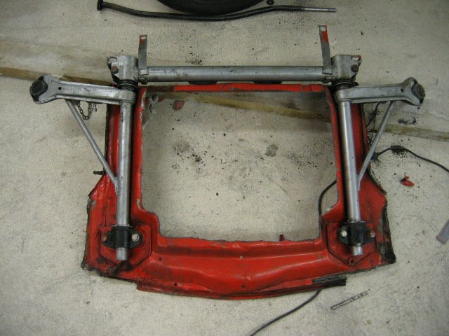

I don't know if i should call this progress but here is what we did last weekend.
(IMG:http://www.914world.com/bbs2/uploads_offsite/photos1.blogger.com-179-1274376551.1.jpg)
(IMG:http://www.914world.com/bbs2/uploads_offsite/photos1.blogger.com-179-1274376551.2.jpg)
I was thinking that i just make a frame out of the 30*50mm square tube which i
use to tie the front and rear attachment points together. Then i raise the whole setup
1" and weld roll gage tubes to it. How does it sound? Do you think there is something else
i should do to make the front better? When i have the frame part ready i will put it on a table and then measure that all are square with rear axle.
Here is the rear
(IMG:http://www.914world.com/bbs2/uploads_offsite/photos1.blogger.com-179-1274376551.3.jpg)
i'am trying to get the suspension ready so i can lift the car over it. This should happen in a next 3 weeks.
