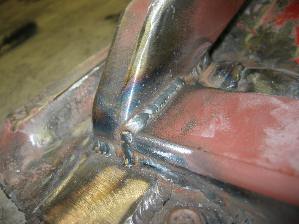

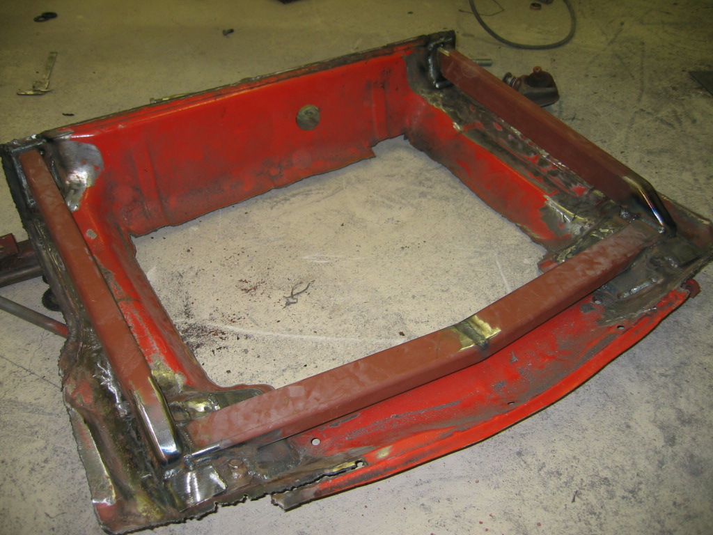

Some progress.
Front axle frame allmost ready.(IMG:http://www.914world.com/bbs2/uploads/blog-1140635645.jpg)
detail shot
(IMG:http://www.914world.com/bbs2/uploads/blog-1140635975.jpg)
Friday i will have change to finish the frame. Then i can lift the front to table and start measuring.
