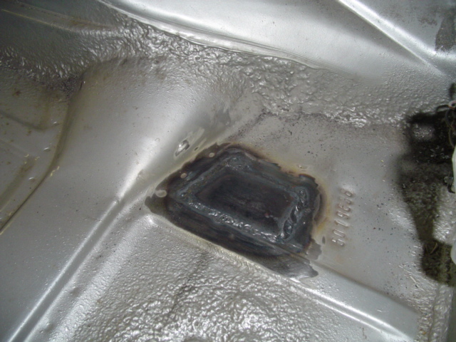

Decided to tackle my sway bars this weekned. The front is a Tarret and the rear is a stocker. I did the front setup today. Started by drilling the tub. 1 1/8" holes for the Tarret bar and the three mounting holes. Then made some backing/nut plates out of some flat stock (1/4" plate) I had laying around.
Here's the backing/nut plate next the Tarret bushing block:

Here's the re-enforcing plates in the trunk (aka......junk in the trunk (IMG:http://www.914world.com/bbs2/html/emoticons/biggrin.gif) )
