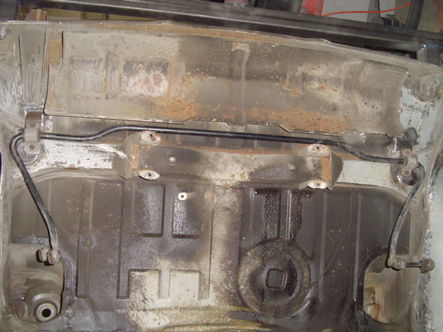

Decided to tackle my sway bars this weekned. The front is a Tarret and the rear is a stocker. I did the front setup today. Started by drilling the tub. 1 1/8" holes for the Tarret bar and the three mounting holes. Then made some backing/nut plates out of some flat stock (1/4" plate) I had laying around.
Here's the backing/nut plate next the Tarret bushing block:

And the completed install..........

East coaster   OK..........got around to doing the rear bar mount...   Feb 26 2006, 04:53 PM
East coaster   Welded the brackets in.......   Feb 26 2006, 04:54 PM
East coaster   other side......   Feb 26 2006, 04:55 PM
East coaster   Here's the re-enforcing plates in the trunk (a...   Feb 26 2006, 04:56 PM
East coaster   other side   Feb 26 2006, 04:57 PM
East coaster   And the completed install..........   Feb 26 2006, 04:58 PM
