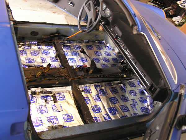

Getting ready to put the interior back in and need some new carpet. Can anyone recommend which one I should purchase? Looking for black, or the charcoal color. I see a lot of carpet
kits out there (mostly on Evilbay).
Also, after removing the tar and rust, I metal readied and applied the por-15 stuff.
I'm concerned about having a lot of road noise now that the tar is gone. The aftermarket adhesive pads for sound deadening are really expensive. Does anyone have any suggestions for a cheaper alternative? Is something to deaden the sounds necessary with the carpet in there?

blitZ   I used Fat Mat for replacing the heavy tar mats f...   Mar 10 2006, 01:13 PM
blitZ   floor...   Mar 10 2006, 01:14 PM
blitZ   carpet...   Mar 10 2006, 01:15 PM
ewdysar   Blitz, Which kind of FatMat did you use? I under...   Mar 10 2006, 02:19 PM
blitZ   <...   Mar 10 2006, 02:34 PM
