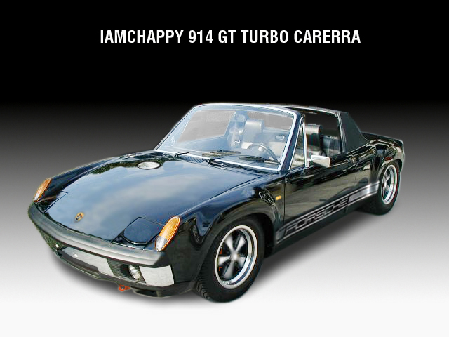

iamchappy
post Mar 10 2006, 07:14 PM
It all happens so fast!
Posts: 4,893
Joined: 5-November 03
From: minnetonka, mn
Member No.: 1,315
How the finished product should look, with brake ducts fabricated into a GT valance

iamchappy   Before:   Mar 10 2006, 06:56 PM
iamchappy   As it comes together now: C2 pistons and cylinders...   Mar 10 2006, 07:08 PM
iamchappy   under   Mar 10 2006, 07:09 PM
iamchappy   side with air duct in spoiler   Mar 10 2006, 07:11 PM
iamchappy   How the finished product should look, with brake d...   Mar 10 2006, 07:14 PM
turboman808   That looks pretty cool. That's pretty much ho...   Mar 10 2006, 07:35 PM
iamchappy   Transmission cooler is shown underneth. The interc...   Mar 10 2006, 07:46 PM
iamchappy   Turbo oil is scavenged from the turbo by a 930 cam...   Mar 10 2006, 07:48 PM
iamchappy   My external oil cooler is mounted up front like ev...   Mar 10 2006, 07:51 PM
