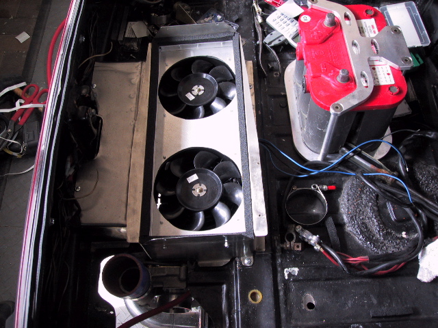

iamchappy
post Mar 10 2006, 07:46 PM
It all happens so fast!
Posts: 4,893
Joined: 5-November 03
From: minnetonka, mn
Member No.: 1,315
Transmission cooler is shown underneth.
The intercooler is fed fresh air through the duct in the spoiler, the air is pulled through
the intercooler via 2 - 7" electric fans and ducted out under and through the transmission cooler.

iamchappy   Transmission cooler is shown underneth. The interc...   Mar 10 2006, 07:46 PM
iamchappy   Turbo oil is scavenged from the turbo by a 930 cam...   Mar 10 2006, 07:48 PM
iamchappy   My external oil cooler is mounted up front like ev...   Mar 10 2006, 07:51 PM
