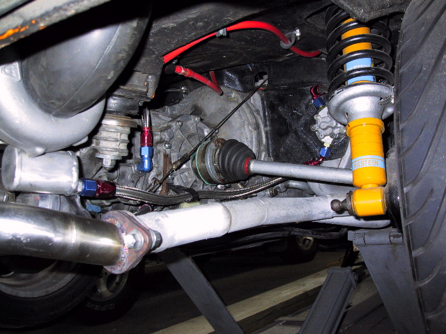

iamchappy   Transmission cooler is shown underneth. The interc...   Mar 10 2006, 07:46 PM
iamchappy   Turbo oil is scavenged from the turbo by a 930 cam...   Mar 10 2006, 07:48 PM
iamchappy   My external oil cooler is mounted up front like ev...   Mar 10 2006, 07:51 PM
