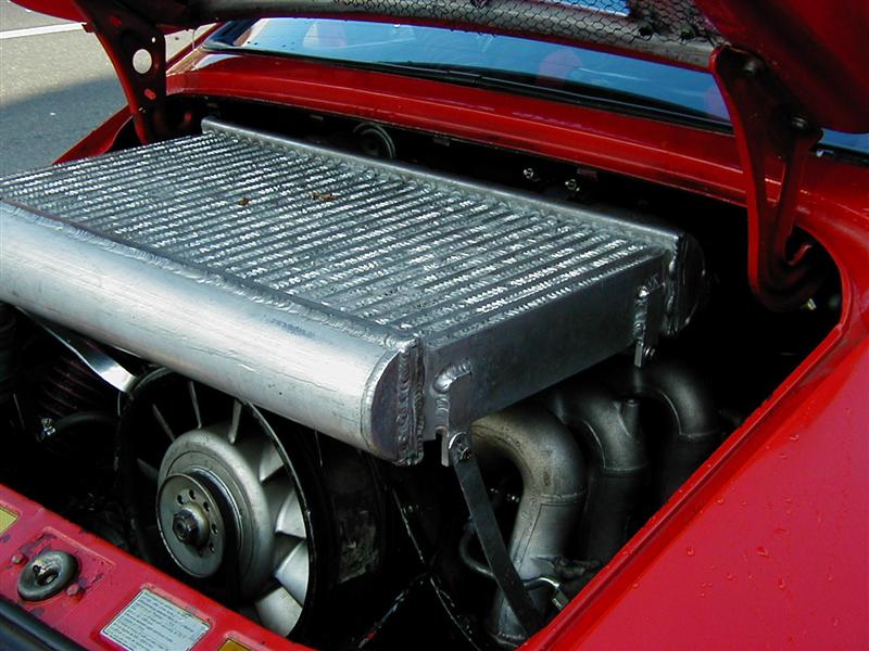

> So has anyone turbo charged there 914, didn't see any on the site

Just curious I haven't seen any turbo porsche motors on here. Is it a heat issue or just not one bothers.

This is a 3.3 930 engine with a 3.2 carrera manifold and EFI, 656 RWHP

iamchappy   Before:   Mar 10 2006, 06:56 PM
iamchappy   As it comes together now: C2 pistons and cylinders...   Mar 10 2006, 07:08 PM
iamchappy   under   Mar 10 2006, 07:09 PM
iamchappy   side with air duct in spoiler   Mar 10 2006, 07:11 PM
iamchappy   How the finished product should look, with brake d...   Mar 10 2006, 07:14 PM
turboman808   That looks pretty cool. That's pretty much ho...   Mar 10 2006, 07:35 PM
iamchappy   Transmission cooler is shown underneth. The interc...   Mar 10 2006, 07:46 PM
iamchappy   Turbo oil is scavenged from the turbo by a 930 cam...   Mar 10 2006, 07:48 PM
iamchappy   My external oil cooler is mounted up front like ev...   Mar 10 2006, 07:51 PM

TimT   This is a 3.3 930 engine with a 3.2 carrera manifo...   Mar 10 2006, 08:11 PM
