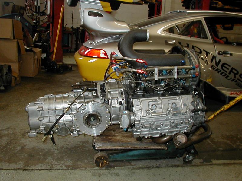

This is a 3.8 with ITBs and 2 injectors /cylinder..
if you were creative you could fit this engine in a 914 engine bay.
800+ hp...

TimT   We have built some seriously powerful turbo /6 eng...   Mar 10 2006, 08:07 PM
TimT   This is a 3.3 930 engine with a 3.2 carrera manifo...   Mar 10 2006, 08:11 PM
TimT   This is a 3.8 with ITBs and 2 injectors /cylinder...   Mar 10 2006, 08:16 PM
