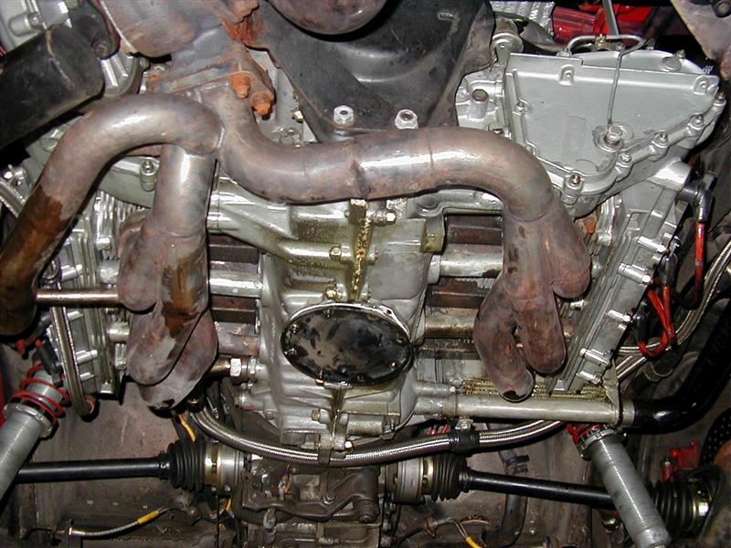

headers, though this pics doesnt help the teener poeple out there

TimT   headers, though this pics doesnt help the teener ...   Mar 10 2006, 08:35 PM
