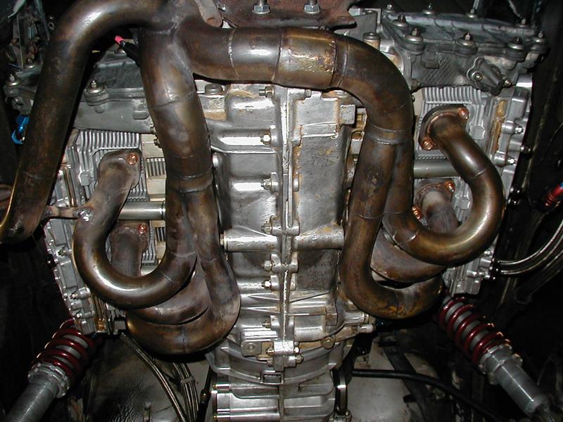

TimT   headers, though this pics doesnt help the teener ...   Mar 10 2006, 08:35 PM
TimT   another set of headers   Mar 10 2006, 08:40 PM
TimT   Remember build your engine right, you dont want to...   Mar 10 2006, 08:42 PM
TimT   or this http://www.914world.co...   Mar 10 2006, 08:44 PM
