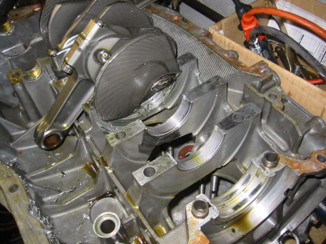

Remember build your engine right, you dont want to see this (IMG:http://www.914world.com/bbs2/html/emoticons/ohmy.gif)

TimT   We have built some seriously powerful turbo /6 eng...   Mar 10 2006, 08:07 PM

TimT   Remember build your engine right, you dont want to...   Mar 10 2006, 08:42 PM
TimT   or this http://www.914world.co...   Mar 10 2006, 08:44 PM

TimT   Chappy has done an impressive job on his turbo ins...   Mar 10 2006, 09:47 PM
