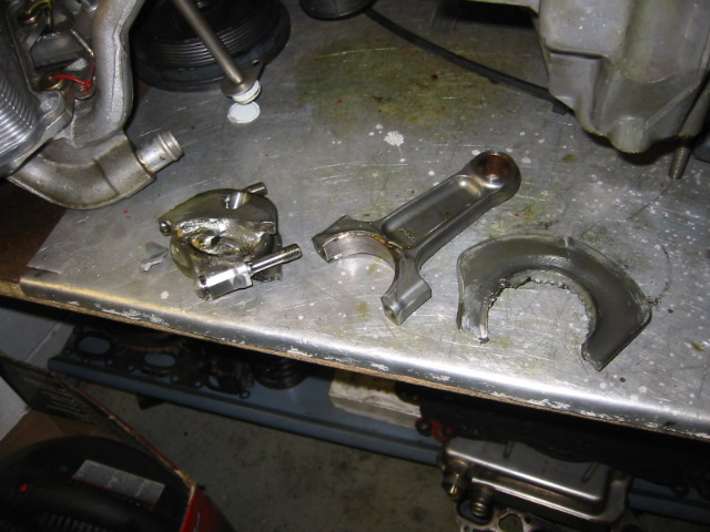

TimT   We have built some seriously powerful turbo /6 eng...   Mar 10 2006, 08:07 PM
TimT   This is a 3.3 930 engine with a 3.2 carrera manifo...   Mar 10 2006, 08:11 PM
TimT   This is a 3.8 with ITBs and 2 injectors /cylinder...   Mar 10 2006, 08:16 PM
iamchappy   http://www.914world.com/bb...   Mar 10 2006, 08:29 PM
TimT   headers, though this pics doesnt help the teener ...   Mar 10 2006, 08:35 PM
TimT   another set of headers   Mar 10 2006, 08:40 PM
TimT   Remember build your engine right, you dont want to...   Mar 10 2006, 08:42 PM
