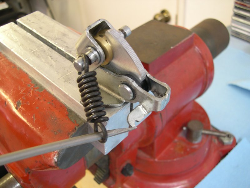

OK, the first step is to remove your door stay mechanism from the door. I won't cover this step here. It's pretty simple, but if necessary, refer to this article on the Pelican Parts website. Install the mechanism in the vise, clamping on the door stay itself.

Reinstalling the springs can be a real hassle. I use a blade screwdriver with a round shank (Craftsman). Be careful and wear your safety glasses!
