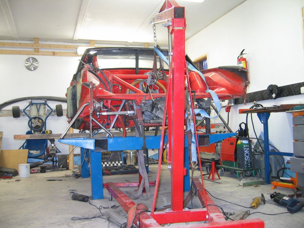

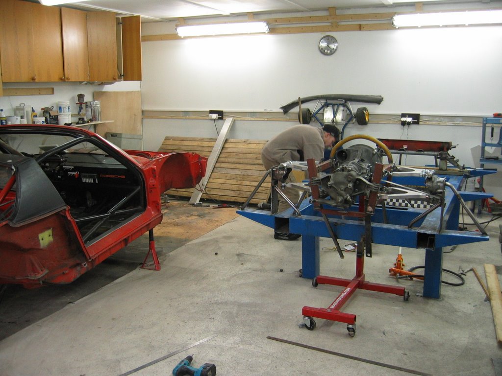

We got the front axle placed in a table and corrected some misalligments. Now the front and rear are in right place and body is about to be welded. We are going to raise the front about 2" and match the rear to that. Here's some pictures. Thanks BadJuha, Topi and Henkka.
