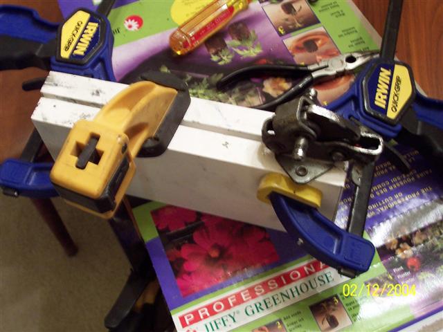

sk8kat1
post Mar 13 2006, 08:49 PM
Posts: 911
Joined: 10-October 05
From: belvidere ,IL
Member No.: 4,937
my "vise"
