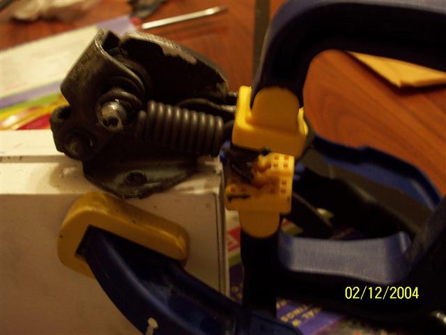

sk8kat1   ok I just finished my door stays.. this kit is gre...   Mar 13 2006, 08:48 PM
sk8kat1   my "vise"   Mar 13 2006, 08:49 PM
sk8kat1   how I kept the spring from taking flight while rem...   Mar 13 2006, 08:50 PM
sk8kat1   how I kept my springs from taking flight when rein...   Mar 13 2006, 08:51 PM
