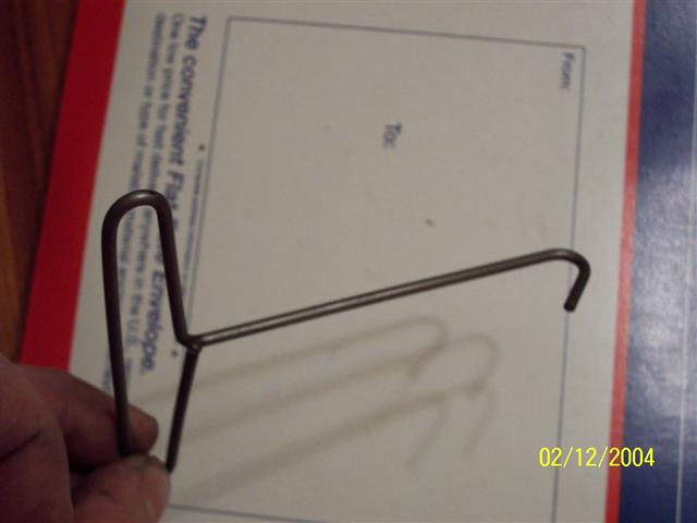

sk8kat1
post Mar 13 2006, 08:51 PM
Posts: 911
Joined: 10-October 05
From: belvidere ,IL
Member No.: 4,937
how I kept my springs from taking flight when reinstalling... yes, it is a spring puller from my motorcycle exhaust

sk8kat1   how I kept the spring from taking flight while rem...   Mar 13 2006, 08:50 PM
sk8kat1   how I kept my springs from taking flight when rein...   Mar 13 2006, 08:51 PM
