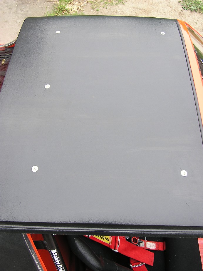

Jeroen   just use bonnet pins to hold the roof down...   Mar 14 2006, 06:21 AM
drew365     Mar 14 2006, 09:45 AM
kart54   Drew, I just did almost the same thing but I ...   Mar 14 2006, 12:57 PM
