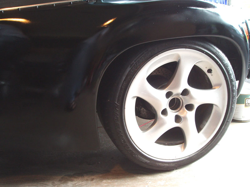

well, i'm going for it.
this is on FG fenders. i did one coat yesterday and one today. i can already tell that spending time on prep is critical. LOL...
looks like it's going to all come off now.
by next week i should have a couple coats of primer and atleast one sand on her. then i'll try the paint again... =-)

Dr. Roger   well, i'm going for it. this is on FG fenders...   Mar 25 2006, 06:28 PM
