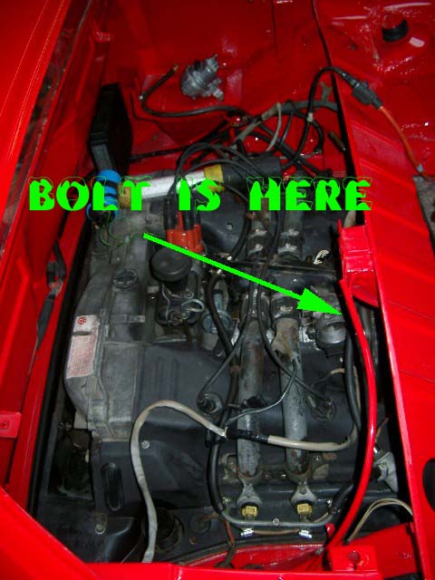

last week my starter went to draggin something fierce.so i purchased another and decided id better get it changed in a bit of a hurry. [daily driver] so i went under after unhooking the battery and disconnected the wires ,got the easy bolt out ,and then went to reach over the starter to get to the other.well i figured out a socket wouldnt go on the bolt and fumbled with it for 2 evenings without getting a rubber neck and takeing a peak..today i did and found out it has tits, big ones. well big enough to keep the socket off of it ,and with no room for a wrench ?.....well i figure there is a way to get to it another way beings this looks as if its purpose is to hold the bolt ,,,,,so can someone give me a pointer here.....and mayby awnser the important question ''why''? oh,its a 72 1.7 (IMG:style_emoticons/default/headbang.gif)

gotta love photoshop ...

ejm   Sounds like you have one of the bolts with the "D"...   Sep 15 2003, 06:01 PM
driver66   yep, that be it ..... dont tell me ive got to yank...   Sep 15 2003, 06:13 PM
Bleyseng   Use a lite or flashlite to shine on the other sid...   Sep 15 2003, 06:16 PM

Eric Taylor   Take out the air cleaner it should give you a lot ...   Sep 15 2003, 08:09 PM
-P-   Like the other guys said pull the air cleaner and ...   Sep 15 2003, 09:19 PM
driver66   again,thanks alot guys.............i couldnt find...   Sep 16 2003, 10:19 PM
ninefourteener   I learned this the hard way...... didn't know ...   Sep 17 2003, 08:11 AM
