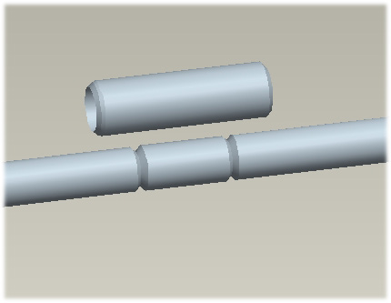

QUOTE (groot @ Mar 28 2006, 12:55 PM)
Do it!!!! It'll make you feel good (IMG:http://www.914world.com/bbs2/html/emoticons/drooley.gif)
Seriously, put a nice chamfer on both sides and build the weld carefully and it will be plenty strong.
watch out, Muellers going to be playing with power tools (IMG:http://www.914world.com/bbs2/html/emoticons/screwy.gif)

groot   Wider is better, as you know. I've done it (by...   Mar 28 2006, 12:43 PM
groot   And... when I made my camber plates I actually had...   Mar 28 2006, 12:45 PM
Mueller     Mar 28 2006, 12:49 PM
groot   You have a welder, right? They can be lengthened ...   Mar 28 2006, 12:49 PM
Mueller     Mar 28 2006, 01:08 PM
groot   Do it!!!! It'll make you feel ...   Mar 28 2006, 01:55 PM
