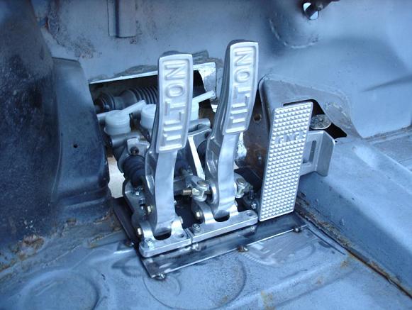

I need to "trim" the center tunnel a little so my pedals can fit better. How much of a structural factor is it to the car? see pics.

lapuwali   Looks to me like it would be a lot easier if you j...   Mar 29 2006, 07:01 PM
Mueller   now that you have a cage you should be fine...you ...   Mar 29 2006, 07:03 PM

Terrance   Boxing the pedal area is what I am going to do. I...   Mar 29 2006, 07:07 PM
Jeroen   the tunnel is part of the structure, but since you...   Mar 29 2006, 07:09 PM

byndbad914   Terrance - have you moved your drivers seat over a...   Mar 29 2006, 07:32 PM

bondo   I cut the top of my tunnel out (to put stuff in th...   Mar 29 2006, 07:36 PM
Terrance   byndbad914 - I will definately have to move the se...   Mar 29 2006, 08:25 PM
Terrance   I figured it out. Tilton makes shorter master cyli...   Mar 29 2006, 09:55 PM

Mugs914   Here's a somewhat lame shot of the pedal box f...   Mar 30 2006, 10:30 AM
Mugs914   This gives an idea of where the seat is situated.....   Mar 30 2006, 10:31 AM
Terrance   Mike, Need info on your gas pedal! ...   Mar 30 2006, 12:29 PM
Terrance   Andys, byndbad914   Terrance, I am working on hopefully mounting my p...   Mar 30 2006, 03:53 PM
