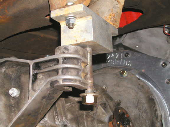

The fab'd transmission mount ala Brad N Crew won't work with the Jaide bracket since it's not positioned as far back. I was hoping another bolt hole could be drilled further back but it is about where the rear vertical face is. (IMG:http://www.914world.com/bbs2/html/emoticons/ohmy.gif)

neo914-6   The fab'd transmission mount ala Brad N Crew w...   Apr 2 2006, 01:12 AM
neo914-6   Looks like I will need to shorten this...   Apr 2 2006, 01:13 AM
neo914-6   Or buy a Renegade adapters and sport trans mount (...   Apr 2 2006, 01:15 AM
Andyrew   You could just make that piece... solid aluminum. ...   Apr 2 2006, 04:53 AM
turbo914v8   I have a set of the Renegade adapters PM me if you...   Apr 2 2006, 10:11 AM
