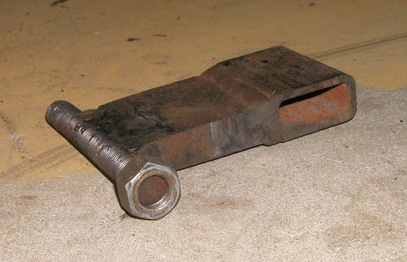

neo914-6   I actually got some time on my V8 car Sunday. Had...   Apr 3 2007, 01:46 AM
neo914-6   the differences between the bolt-on extension and ...   Apr 3 2007, 01:48 AM
neo914-6   other side   Apr 3 2007, 01:50 AM
McMark   I do my share of 'mangling' stock parts, b...   Apr 3 2007, 03:53 AM
