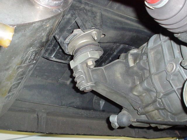

neo914-6   I expected to use a hammer on the firewall for val...   Apr 2 2006, 01:07 AM
neo914-6   The fab'd transmission mount ala Brad N Crew w...   Apr 2 2006, 01:12 AM
neo914-6   Looks like I will need to shorten this...   Apr 2 2006, 01:13 AM
neo914-6   Or buy a Renegade adapters and sport trans mount (...   Apr 2 2006, 01:15 AM

neo914-6   I actually got some time on my V8 car Sunday. Had...   Apr 3 2007, 01:46 AM
neo914-6   the differences between the bolt-on extension and ...   Apr 3 2007, 01:48 AM
neo914-6   other side   Apr 3 2007, 01:50 AM
