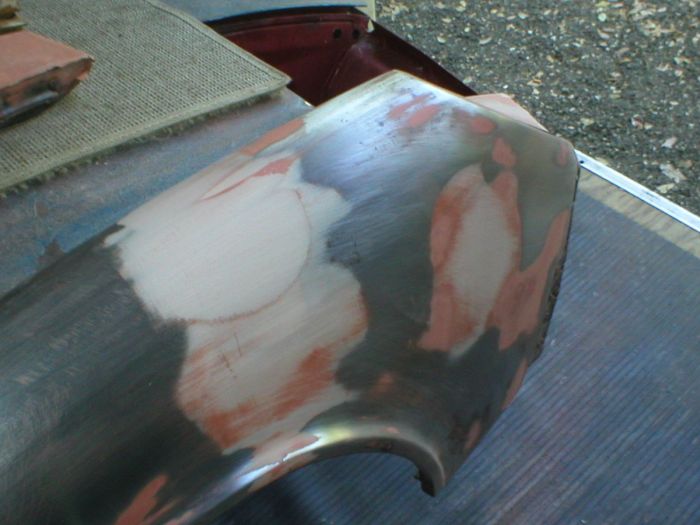

Ground down the welds, added several thin layers of bondo and a single layer of spot putty. This should hold it until I get to prime, then paint it. I'll prime it with etch primer soon. BTW, the bondo took most of the day. Bondo, sand, repeat as needed....
