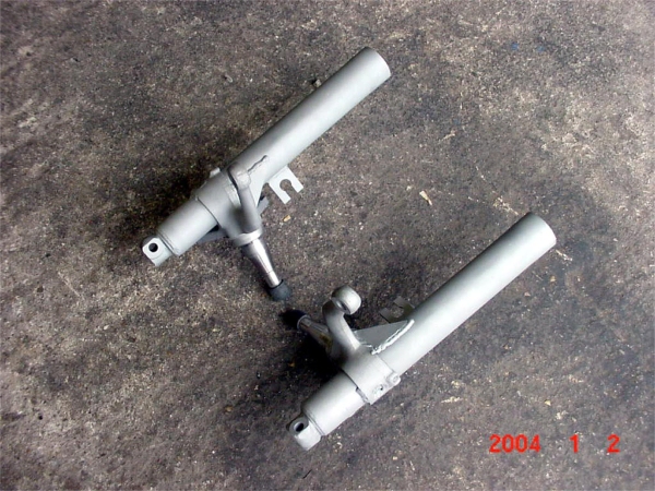

rickyhgarcia   This is what they look like before powder coating....   Apr 3 2006, 12:05 PM
