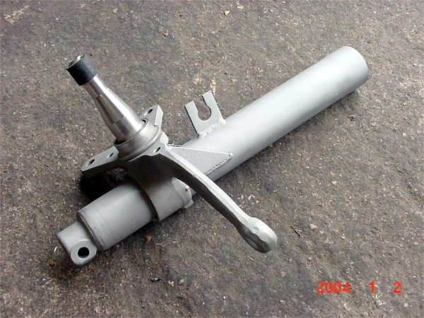

rickyhgarcia   This is what they look like before powder coating....   Apr 3 2006, 12:05 PM
rickyhgarcia   Left...   Apr 3 2006, 12:10 PM
rickyhgarcia   Right...   Apr 3 2006, 12:11 PM
