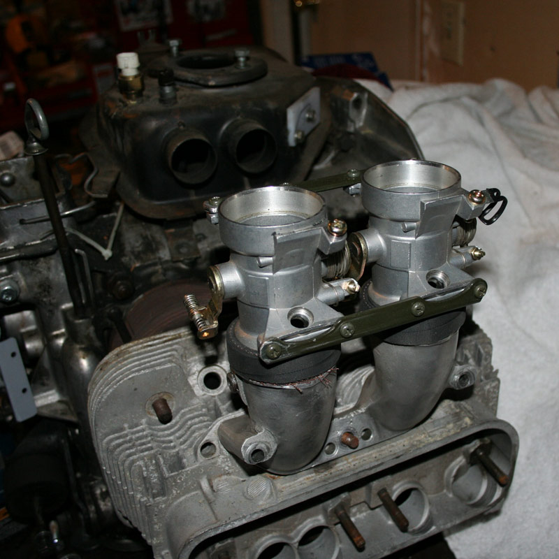

looked into it....I already bought the hose ($16 per ft), and don't want to spend too much time and effort on these...
here is them mounted on one side of the motor....
I screwed up, these manifolds are for 2.0 3-bolt heads...my motor is a 1.8 with 4-bolt heads, anyone want to buy these?? (IMG:style_emoticons/default/smile.gif)
(2.0 head in picture is thrashed beyond repair and for mock up use)

Aaron Cox   Mike, since the TB's are not rigid mounted, h...   Apr 3 2006, 08:33 AM
jonwatts   ...   Apr 3 2006, 08:57 AM
Porcharu     Apr 3 2006, 09:29 AM
Mueller   <...   Apr 3 2006, 12:17 PM
Mueller   ugly, but it'll work.....   Apr 3 2006, 12:18 PM
thesey914   mike, surely those manifolds have what looks like ...   Apr 3 2006, 02:48 PM
