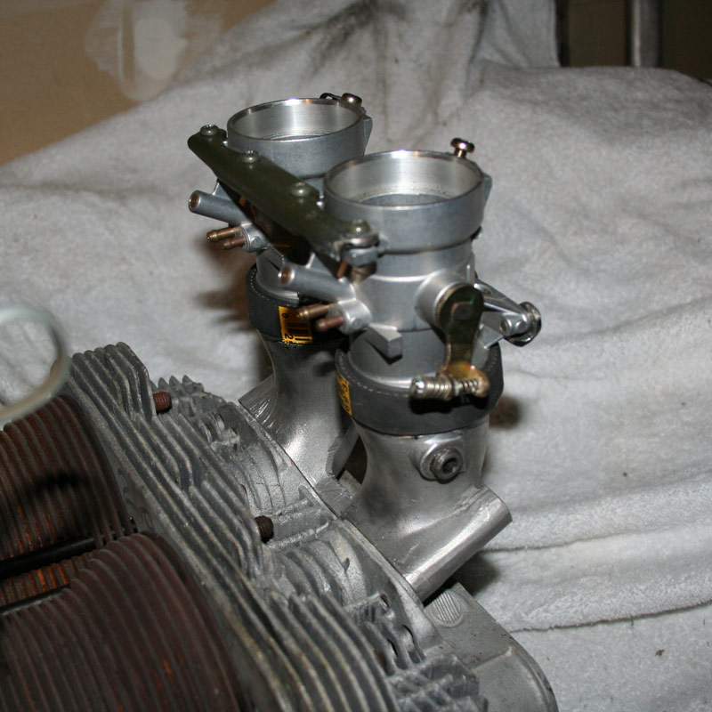

The cost of aftermarket throttle bodies is way up there, the bottom of scale we have the CB Performance units which are about $250 each and the rest are easily 2X that about.....
so I swung by the motorcycle salvage yard in Fremont today and picked up these beauties (IMG:http://www.914world.com/bbs2/html/emoticons/smile.gif)
45mm at the butterfly....they taper down to 42.5mm at the bottom...
includes a nice TPS and injectors...I doubt the injectors flow enough, but who knows, I'll find out once I get the specs....
no idea of what bike they came off of yet.....price was $125

ugly, but it'll work.....

Mueller   played with the TB's a little over the weekend...   May 24 2005, 03:36 PM
Mueller   adapter ideas: http://www.91...   May 24 2005, 03:39 PM
Mueller   adapter 2.... this one would have a counterbore f...   May 24 2005, 03:42 PM
Randal   Nice designs Mike. Those look much shorter th...   May 24 2005, 03:56 PM
Cloudbuster   Adapter one! Go with what the factory did. H...   May 24 2005, 03:58 PM
Aaron Cox   rubber: well they use rubber boots on turbo setup...   May 24 2005, 03:59 PM

MecGen   Hey Mike The size of the injector hole/mounts, is ...   May 24 2005, 04:05 PM

jhadler   Hey Mike, Those Wakisaki throttles look great...   May 24 2005, 04:25 PM

Aaron Cox   throttle linkage cant be too hard. mike i had an...   May 24 2005, 05:06 PM

Paul Illick   Cool. I'm doing the same thing using Suzuki G...   May 24 2005, 07:33 PM

Mueller   ...   Apr 2 2006, 12:55 AM

Aaron Cox   Mike, since the TB's are not rigid mounted, h...   Apr 3 2006, 08:33 AM

Mueller   <...   Apr 3 2006, 12:17 PM
Mueller   ugly, but it'll work.....   Apr 3 2006, 12:18 PM
thesey914   mike, surely those manifolds have what looks like ...   Apr 3 2006, 02:48 PM
