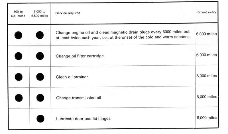

Why change the oil at all?
the cap'n is correct.....many manufactures of transmissions and rear diffs do not recommend a regular draining and re-filling..
Hmm your both wrong...
Ive taken the liberty of attaching a scan of a Porsche Drivers Manual..This scan is from a manual from an early 70's 911...
and yes the recommended service interval is 6000 miles..
Crustholio.. how you have led your flock astray....
Im aware that the oils we use in our cars now are much improved from the 1970's....
so change your gear oil once a year ;-)
