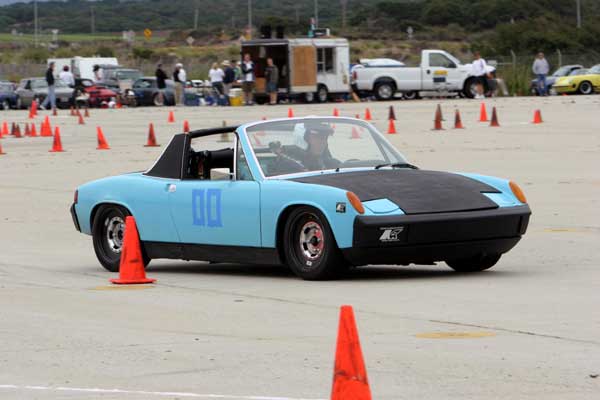

But if this is going to be an an AX car there is plenty of cheap new and used fiberglass. Might as well get as much weigh savings as possible. Weight is biggest enemy of an AX car. Why not get rid of as much as you can?It must be the old competitive cyclist in me.
I ran super ugly last year with $2.99 rattle can painted flat black hoods and bumpers. But the car did move faster.
