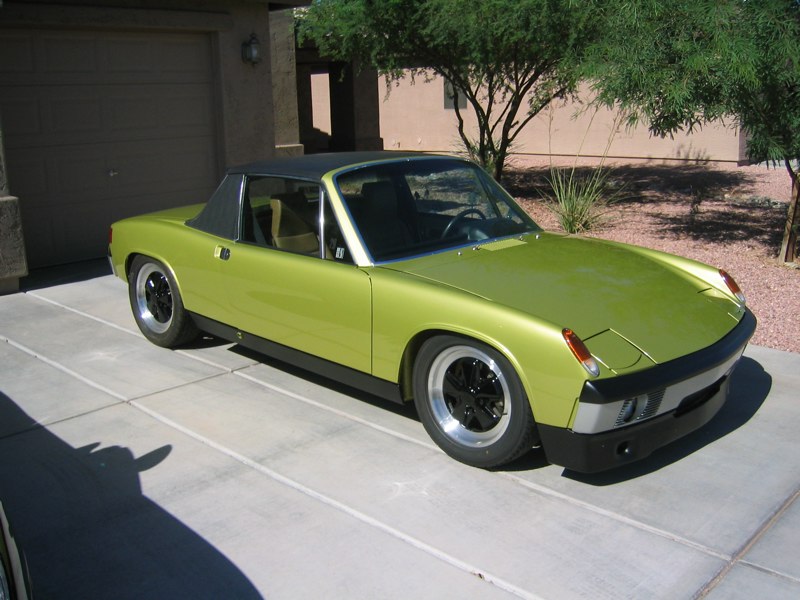

John's old Patrick Motorsports Car had fiberglass decklids and bumpers along with a high performance engine. I realize that the original intention for that car was racing, but it was used on the street and I think it still had the creature comforts, heater, etc.
Did it benifit from the lightened parts? Would it's performance be about the same with the stock items?
