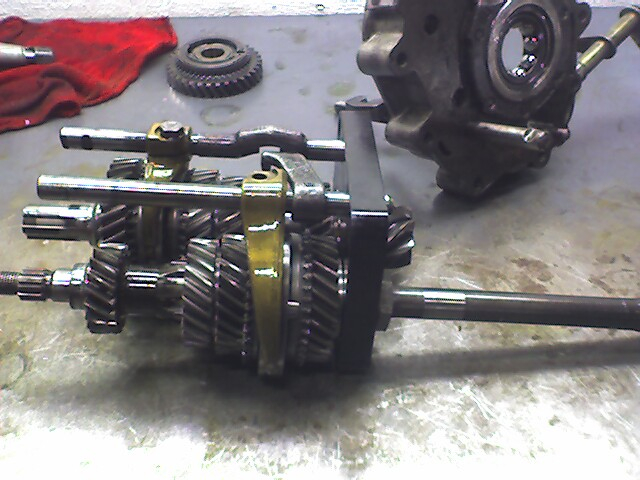

Prior owner, Jim Chambers, had MSX gears for autocrossing. Car is quick, but it made it trying to be on the interstate. I decided to put the standard Z gear in for 5th. This work is being done by Tab Tanner at Autobahn Garage in Findlay Ohio. Here we are aligning the engine/jack fitting.

we changed one of the shifting forks, too, as one looked and felt loose/worn. it would sometimes not shift into third. hope this solves that problem.
